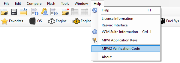

3. Open either VCM Scanner or VCM Editor.
4. In the menu bar, select Help > MPVI2 Verification Code.
5. Write down the serial number and verification ID that the VCM software gives you (or keep the window open for cutting and pasting).

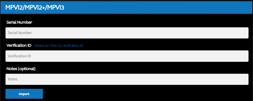

7. Navigate to the customer account page at https://www.hptuners.com/my-account/.
8. Select the My Devices tab on your account page. You will find this tab located in the sidebar on the left side of the screen.
9. In the fields under the MPVI2/MPVI2+/MPVI3 heading, enter the serial number and the verification ID you received in Step 4.
10. Click Import. A summary of the new device will appear below the fields you just filled out.
NOTE: If you have registered multiple devices, look for the new device's serial number in the column on the left.
This summary includes information about how many credits are already on the device (if any). It also indicates whether you have licensed the Pro Feature Set or the User Defined Parameters feature for this device. You can use the links here to purchase any of the options listed.
