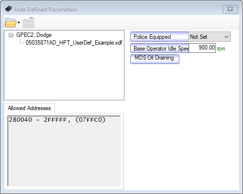

1. Use TunerPro to define the parameters to be added. Save as an .xdf file.
2. In VCM Editor, open the .HPT file to which you want to add parameters.
3. In the menu bar, select Edit > User Defined Parameters.
4. Click .
5. Select the TunerPro (.XDF) file that contains the parameters you wish to import.
6. Click Open. Your parameters will be imported into VCM Editor.

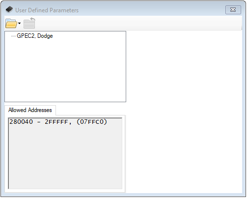

What are the "Allowed Addresses" in the User Defined Parameters window?
The allowed addresses are address ranges that you are allowed to define parameters in. If you try to define a parameter outside these ranges, they will not import and you will not be allowed to edit them.
