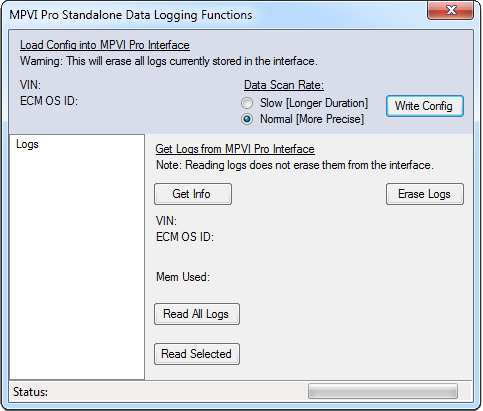

In the menu bar select Vehicle > MPVI Pro Data Logging. The MPVI Pro Standalone Data Logging Functions window appears. |
8.
Click Write Config. This will write your current channel configuration to the MPVI Pro. |

Getting Info From the Device
Click the Get Info button in the MPVI Pro Standalone Data Logging Functions window to display the following information:
VIN and operating system ID of vehicle most recently logged. |
The percentage of log data mem used. |
Logs on the device will be listed in the left column.
Retrieving Log Files From the Device
1.
Connect your MPVI Pro to your computer. |
2.
Select Vehicle > MPVI Pro Data Logging. The MPVI Pro Standalone Data Logging Functions window appears. |
3.
If you want to retrieve all logs from the device: |
If you want to retrieve a particular log:
a.
Click Get Info to retrieve the list of logs on the device. |
a.
In the left column, select the log you want to retrieve. |
NOTE: Retrieving logs will not erase them from the device.
Erasing Logs From the Device
To erase all logs currently stored in the interface, hold the Record and Stop buttons for 2 seconds. The Busy LED will blink until all logs are erased.
This can also be done in VCM Scanner:
1.
With your MPVI Pro connected to your computer, select Vehicle > MPVI Pro Data Logging. The MPVI Pro Standalone Data Logging Functions window appears. |
2.
Click the Erase Logs button. |
NOTE: Neither method will erase your channel config from the device.
