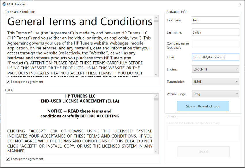

3.
The first time you connect to the ECU, you will be prompted to register it. |
The registration form must be completed and submitted in order to unlock the ECU for tuning:
a.
Check both of the boxes labeled I accept the agreement. |
b.
Fill out the fill out the fields in the Activation Info box. |
c.
Click Give Me the Unlock Code. |
d.
An email containing an activation key will be sent to the e-mail address you entered. Enter this code in the box at the bottom of the window. |

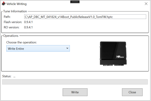

e.
Click . The Vehicle Writing window appears. |
f.
In the Operations box, select Write Entire. |
g.
Click Write. A prompt will appear, asking you to confirm that you wish to perform a write entire operation. |
