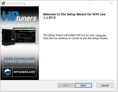

3. Open the downloaded file. The installation wizard will appear.
4. Follow the instructions on screen to complete software installation.
