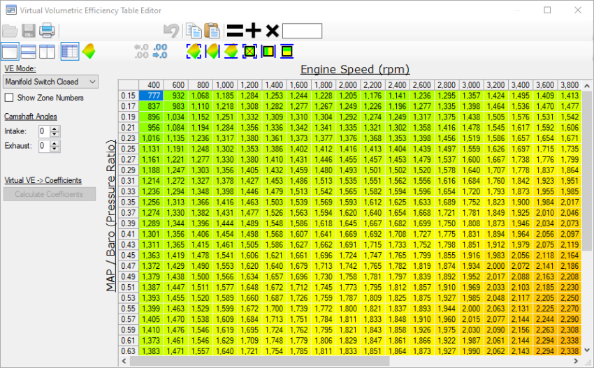

Rather than a traditional VE table, certain GM vehicles use something called "VE coefficients" for volumetric efficiency. If you are tuning such a vehicle, you can use the Virtual Volumetric Efficiency Table Editor window to unpack the VE coefficient data and edit it in a format similar to a conventional VE table.
To access this window, select Edit > Virtual Volumetric Efficiency in the menu bar.

2. | Use the VE Mode and Camshaft Angle controls to select a version of the VE table to configure. |
3. | Configure the data in the VE table using the same methods you would use for a conventional VE table. |
4. | When you have a version of the table data that you want to flash to the vehicle, click Calculate Coefficients to update the VE Coefficients tables based on your modifications. |

VE Mode
Some vehicles have a (runner control) switch in the intake manifold that can be open or closed. It is possible to configure a separate VE table for each position of the switch.
On vehicles that support Displacement on Demand (DoD), an alternate version of each table can be configured for use when cylinders have been deactivated.
Use this dropdown menu to select the version of the VE table to configure.
■ | Manifold Switch Closed |
■ | Manifold Switch Closed (DoD) |
■ | Manifold Switch Open (DoD) |
■ | Manifold Switch Open |
Vehicles that do not have an intake manifold runner control switch use only the Manifold Switch Open version(s) of the table.
Vehicles that do not support DoD use only the non-DoD versions of the table.
