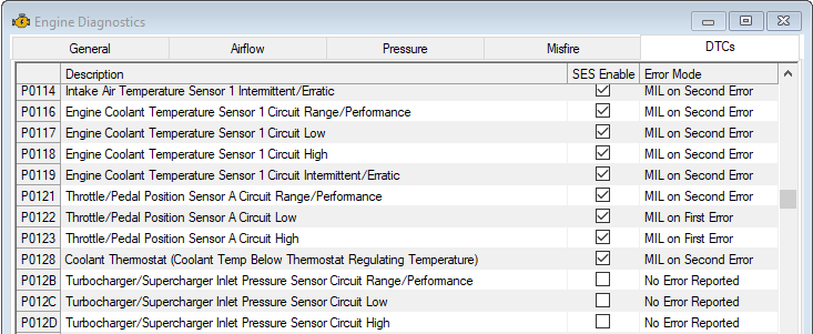

Configuring GM DTCs
On GM vehicles, you can configure whether each DTC is reported and whether it triggers the Malfunction Indicator Lamp (MIL) and the SES lamp.
SES Enable
Checking this box enables the display of the SES/Check Engine/Service Vehicle Soon lamp when this DTC occurs.
Unchecking this box disables the lamp.
NOTE: In some regions, emissions testing will fail automatically if monitoring for emissions-related faults is disabled.
Error Mode
The option selected in this dropdown specifies whether the MIL is lit for this DTC and whether the error is reported.
■ | MIL on First Error. Illuminates the MIL the first time the error is detected. This is appropriate for emissions-related faults that should be reported immediately. |
■ | MIL on Second Error. Illuminates the MIL if the fault is active for 2 consecutive driving cycles. This is appropriate for emissions-related faults that should trigger the MIL if they are detected consistently, but should NOT trigger the MIL when they are detected infrequently. |
■ | No MIL Light. The MIL will not be illuminated for this fault, but the SERVICE lamp will be illuminated. This is appropriate for non-emissions-related faults that should be reported to the driver. |
■ | No Error Reported. Neither the MIL nor the SERVICE lamp will be illuminated for this fault. This is appropriate for non-emissions related faults that should not be reported to the driver. |

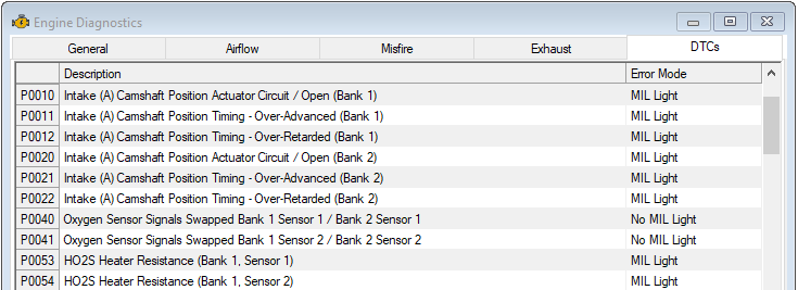

Configuring Ford DTCs
On Ford vehicles, the Error Mode dropdown specifies whether each DTC should be reported and whether the MIL should illuminate when the fault occurs. It has three settings:
■ | MIL Light. The MIL will be illuminated when this fault is detected. This is appropriate for emissions-related faults. |
■ | No MIL Light. The MIL will not be illuminated when this fault is detected. However, the fault will be reported. This is appropriate for non-emissions-related faults that should be reported. |
■ | No Error Reported. The MIL will not be illuminated when this fault is detected and the fault will not be reported. This is appropriate for non-emissions-related faults that should not be reported. |

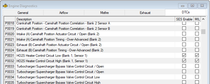

Configuring Dodge/RAM/JEEP/CHRysler DTCs
On these vehicles, there are two settings for each DTC:
■ | SES Enable. Checking this box enables monitoring for this fault. Unchecking it disables the monitor. |
■ | MIL.Check this box if the MIL should be illuminated when this fault is detected. |
