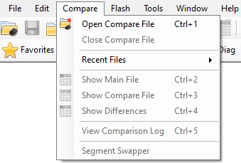

1. | Open the first of the two files you wish to compare by selecting File > Open in the menu bar. |
2. | Once the first file has been opened, the Compare menu becomes available. Select it in the menu bar. |
3. | Select Open Compare File and browse for the second file to compare. |

Once you have opened both files, you will have three separate views available.
■ | Show Main File |
■ | Show Compare File |
■ | Show Differences |
You can access these views either by selecting them in the Compare menu or by clicking the appropriate button in the toolbar of the main VCM Editor window.

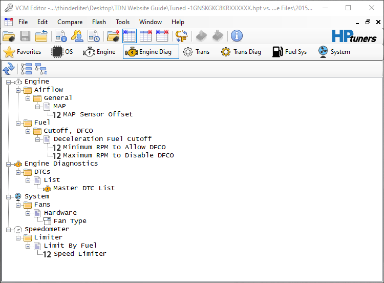

Viewing the Comparison Log
The comparison log displays a quick overview of differences between the two files. To open the comparison log,
■ | In the menu bar, select Compare > View Comparison Log. |
Only parameters supported by both calibrations and of similar types are displayed.
